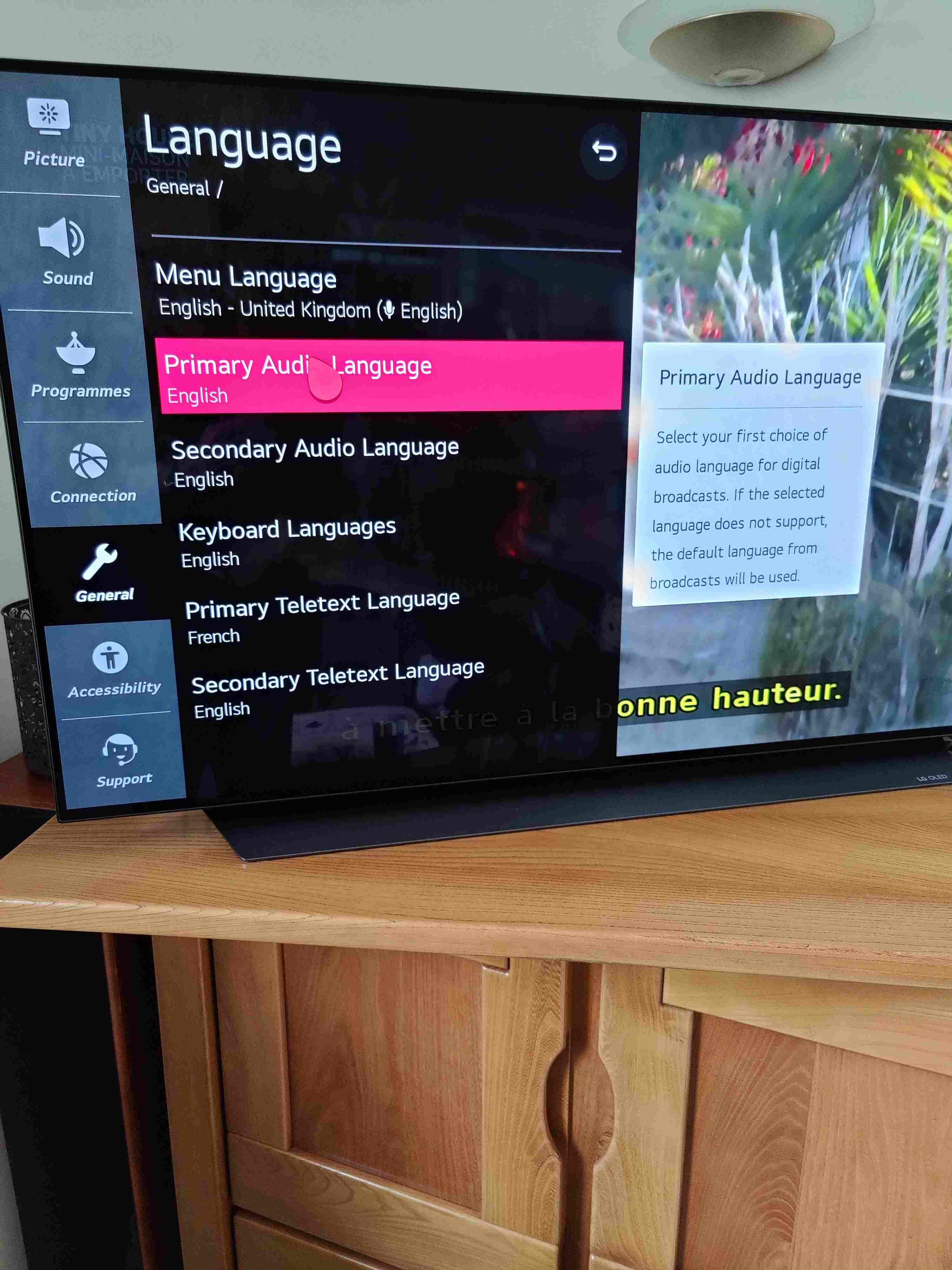

After the reset I did the setup for France and the antenna tuning. Then I checked the TV worked ok. It works fine with no Captions-Subtitles.
I then changed the Primary Language to English (see photo), and immediately Captions are switched on every time I change a channel. You can see them showing in the photo.
If I go into the Parameters, Accessibilty, Subtitles and turn them Off then it is still NOT permenant. They do turn off for the channel being watched but they come back every time I change channels. There is no general option I can see to choose no language to turn OFF captions.
Just the fact of changing the Primary audio Language from French to English appears to activate some internal auto-caption on every time you change a channel.
