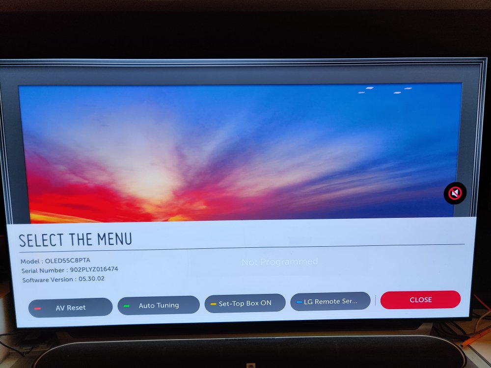

I just arrived on the forum ...I have same model and having same problem since the last update
Software version 05.30.02
