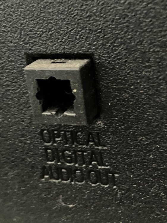

Connecting an external device to my LG 55UQ7570PUJ TV
I want to attach a device called a "StreamLine TV" to my LG TV that would broadcast the TV audio directly to my hearing aids. It apparently requires any one of the following three connectors to be on the TV:
  • TOSLINK cable (optical / digital)
  • Cinch cable (RCA / analog)
  • Jack adapter
Looking at the back of my TV it doesn't have an old-fashioned RCA jack which seems to be what they mean by a "Cinch cable (RCA / analog").
I'm not sure if it has a TOSLINK cable. Searching for 'TOSLINK' in the PDF user guide returns nothing. But on the back of the TV there is a jack called OPTICAL DIGITAL AUDIO OUT. Could that be a TOSLINK connector, maybe just not named as such in the user guide?
3 answers to this question
I am not an expert and hopefully someone more capable will respond but I think a jack adapter is the same as a headphone plug. If your TV has a plug for headphones then that will likely work. You might need to get an adapter to convert the size between 2.5 mm and 3.5 mm. I think the user manual for your TV says it supports headphones but I do not see a plug for that. If no headphone plug then you probably can get audio out using Bluetooth. There are Bluetooth receivers that we can plug headphones into.
Yes, the connector you pictured is also known as TOSLINK. To connect to your device you need a fiber optic cable. It's not a wire. Your StreamLine TV should have the same connector and the cable will have a special connector on both ends that fits in both devices. Since it is fiber optic, be very careful to not put any kinks in the cable.
