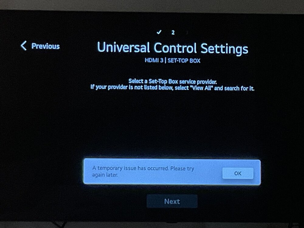

I just reset my tv to factory setting (to get the fireworks pause screen back, don’t judge haha) and now I get the same issue when trying to add universal control to my JBL sound bar.
The most annoying part is that I get to try turning my sound bar on/off using the Magic Remote, but when I press “yes” to confirm the setting, I get the issue prompt… even though there clearly is no issue controlling the sound bar before I try to saving the setting.

I too have got this issue. I am trying to control my Virgin 360 box with the LG Magic remote. The TV initially recognised my 360 box but I could only use on/off and volume controls with the LG remote. Then I tried to set up the tv/remote manually, but got this so-called “Temporary Error - please try later message”. This has been going on for days. I don’t want to do a factory reset if possible as I have changed many settings on the TV and it seems that it won’t fix the problem anyway according to other comment on this thread.  How can I resolve?

This keeps happening to me. I cannot get my C1 to recognise my Sky Q Mini box.  Usually I don't get as far as the screen dump attached. I have reset my TV, reset my Sky box, reset my remote AND changed the batteries but nothing works. After powering OFF the Tv for 5 minutes I get as far as the picture shows but that is it. I have tried all four HDM ports and different HDMI cables. Running out of ideas now.
