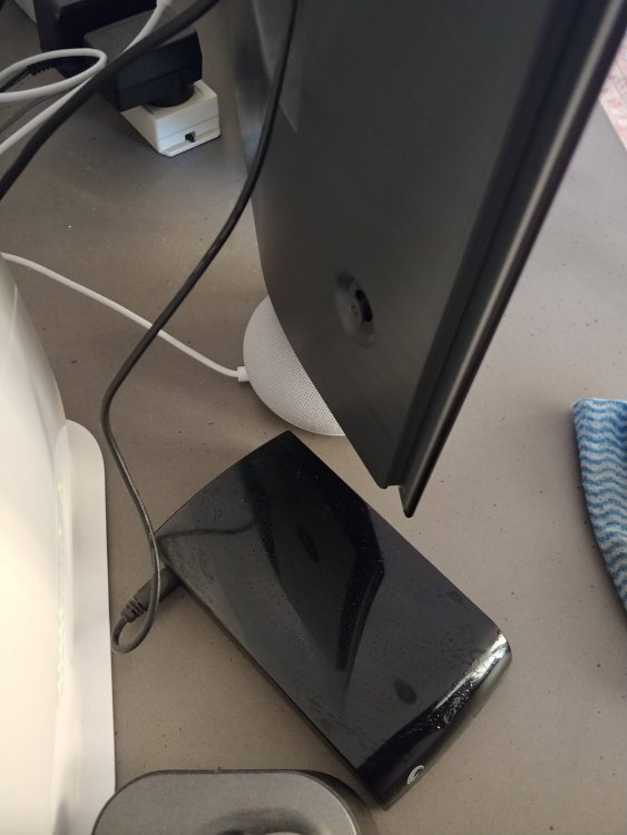

I use an older 1 TB seagate usb hard disk (see photo) which is powered only by the usb.
Here is a screen shot of my TV showing how my 'on screen' controls look. Note. to bring up this display I press the wheel button on my remote control, (you may have to press a different button).

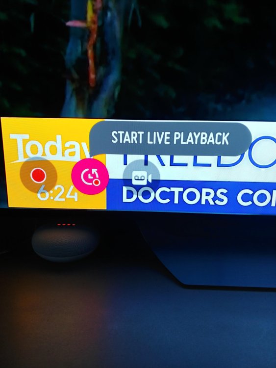

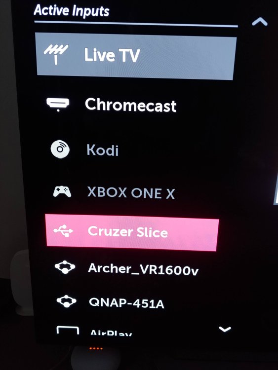

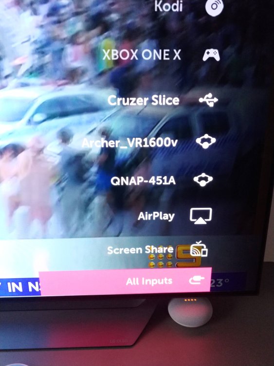

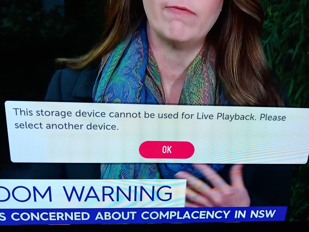

  • Press the Input Device button on your remote. (picture 1) On my remote this a button with a plug picture on it.
  • Keep scrolling down till you get to "All Inputs" and hit the OK button. This will open up a new screen showing all the Active Input devices. (picture 2)

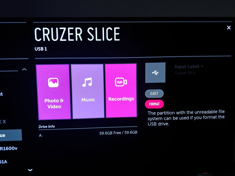

  • Now choose your USB Disk device. Mine is called (Cruzer Slice). Hit the OK button
  • You should now see a screen that allows you to Format the disk (picture 3)
  • Once you have formatted the USB disk - go back to live TV

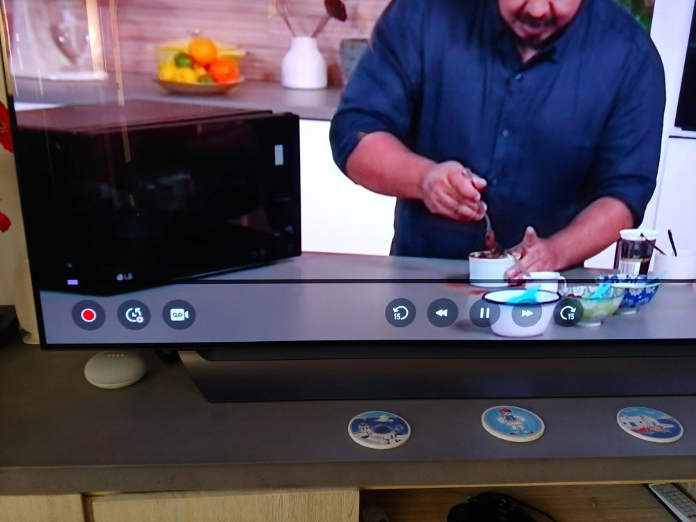

  • Hit the Down Arrow button on your remote (it may be labelled differently on your TV). This will pop up the Live Recording menu on the bottom left of your TV (picture 4)
  • Scroll across (Right Arrow) to Start Live Playback (picture 4)
  • Hit the OK Button.
  • NOTE. If your USB disk is incapable of recording live TV you will get the message in (picture 5). This means that you can't use this USB thumb drive you need a faster USB disk drive.
If all goes well you should now be setup for recording live TV.

Excellent advice, works well, there are no buttons, when you press the wheel it brings up an on screen pause play rewind that you navigate with the magic remote pointer
