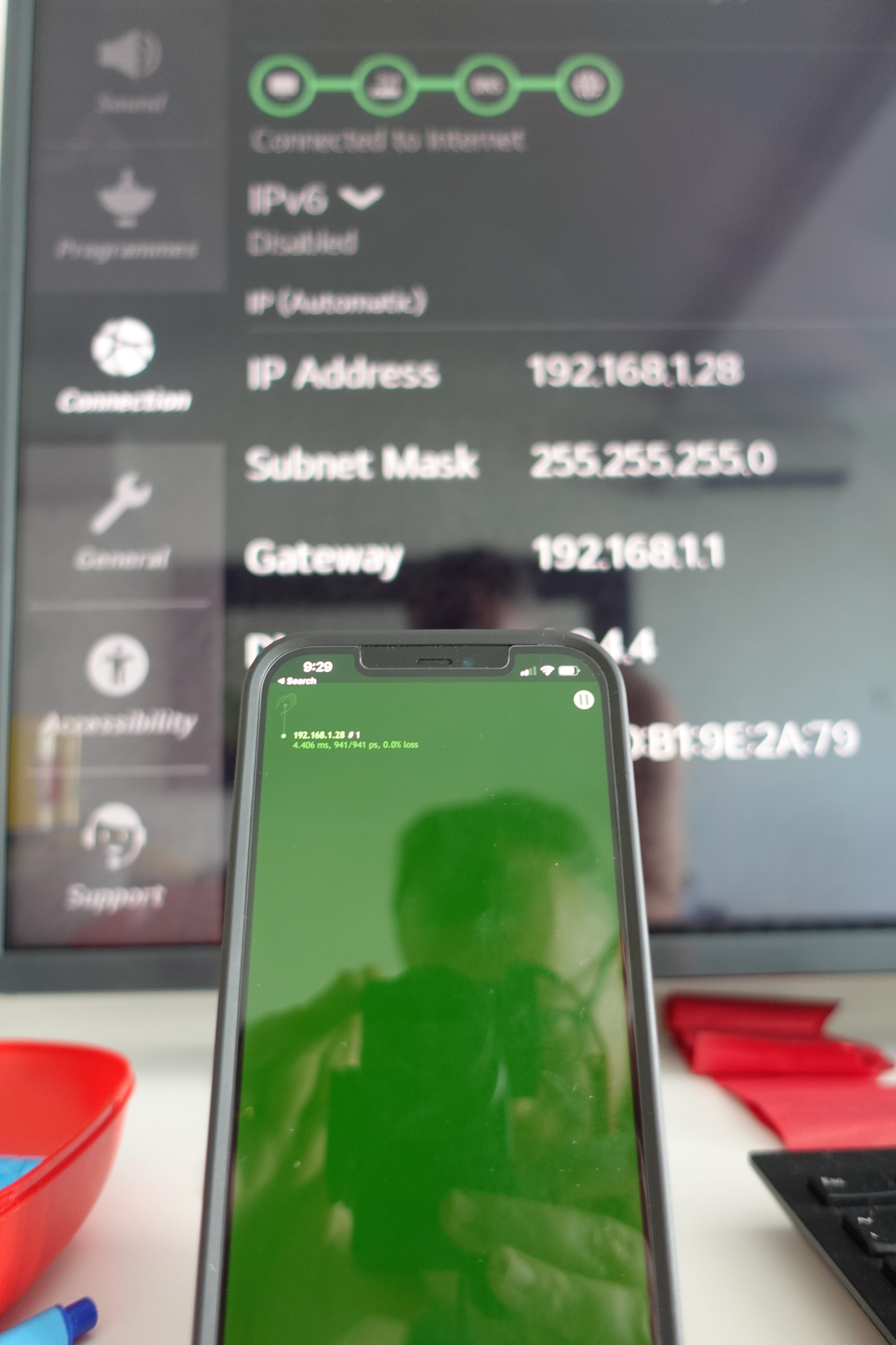

It worked for 2 minutes and now I can't get it working again. Tried power cycling it, no dice. Also casting from Youtube is terribly unstable.
I'm running 03.10.60 of the LG webOS software is that helps and on 14.2.1 on my iPhone 12 Pro Max
Could it be that my TV is faulty?

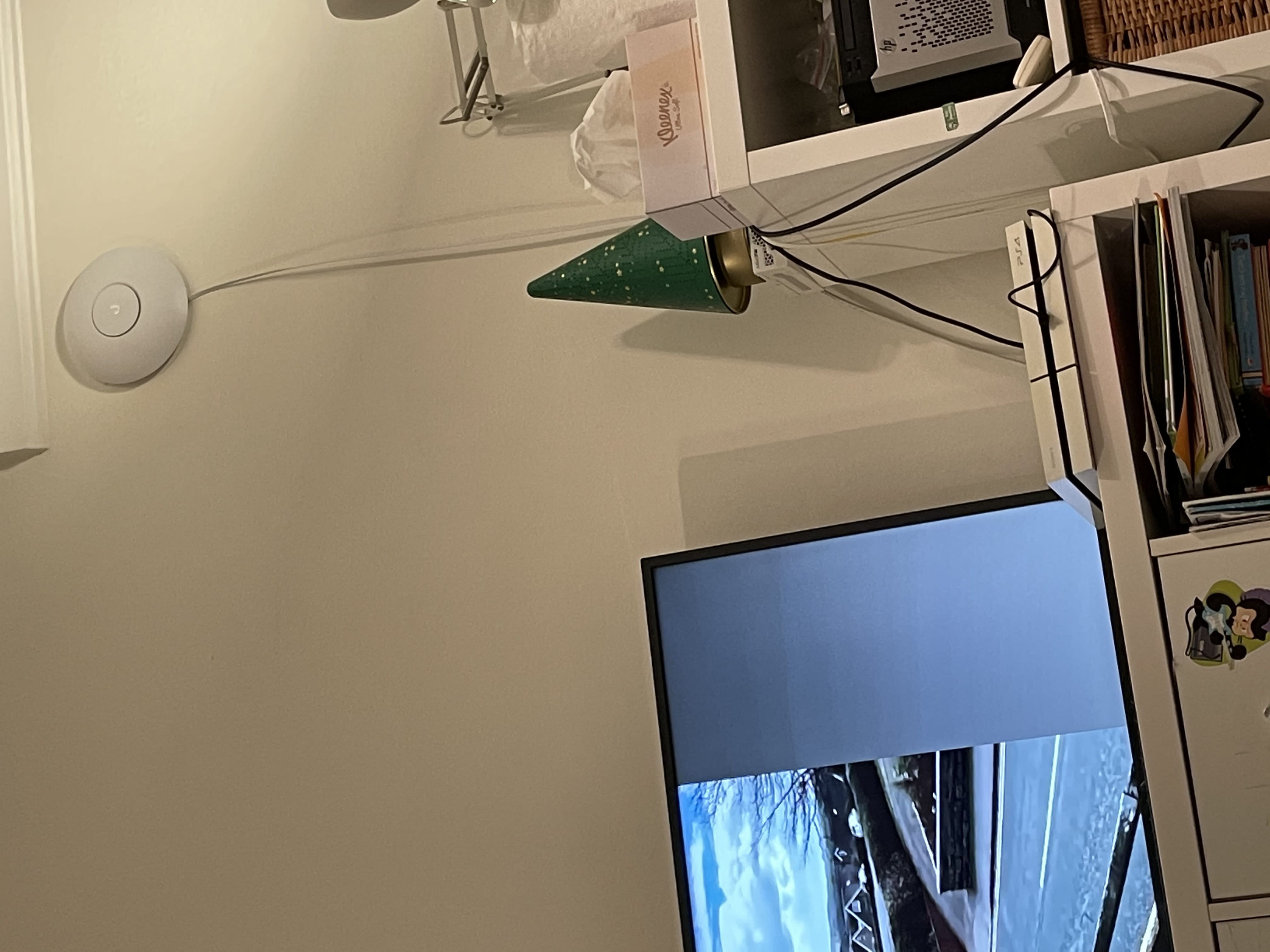

@Kai Hendry Make sure that the room where the TV is, has a good/strong WiFi signal.  Check what your smart phone is using (2.4GHz WiFi band, or the 5GHz band), and make sure that the TV is using the SAME BAND.  NOTE: do not confuse the WiFi 5GHz band with 5G phone capability, that just means "Fifth Generation"..... 😊
Also, check the WiFi strength "bars" icon, on the smart phone, in the same room as the TV to gauge its strength. If you have a laptop, it is much better to check the WiFi signal strength and quality with a nice utility from Nirsoft, called "WiFiInfoView". It is free, check here:
Just download that, unzip it into its own folder, and run the .EXE executable from that new folder (you can right click and creat a shortcut to it on the desktop wallpaper, for later use).
By the way, if you can log into your router, go to the Settings, WiFi (both bands), and go to advanced, check the channels in use, try 36 or 44 for the 5GHz, or 8 for the 2.4GHz, AND ensure that the SSID names for both are not longer than 8 characters, and do not have any special characters in them (like BigAls'WiFi!~ or similar), as some LG TV sets do not like that.
@Kai Hendry Thanks for confirming that, I would NOT have known that fact until you posted it! What about "Check what your smart phone is using (2.4GHz WiFi band, or the 5GHz band), and make sure that the TV is using the SAME BAND."?? If the WiFi is strong, why did you choose to use a wired LAN cable, as that limits you to  100Mbps, and the 2.4GHz WiFi can be 150 - 300MBPS, with the 5GHz around  600 - 900Mbps or more  depending on your router model?  With the connectivity being intermittent, It might be worth disconnecting the TV LAN cable, and trying to see if connecting up the WiFi side stops the issue, BUT use the same band that the phone is using.
I'm 100% sure there is no connectivity issue between the TV and my iPhone.
I think I will return the TV, since no one seems to be able to address the software issues here.

I think I found an issue with my Iphone DNS being set to Google DNS's 8.8.8.8. When I turned it to automatic, it appears to work more reliably.
Another element is to ensure Youtube is exited before trying to Airplay.
