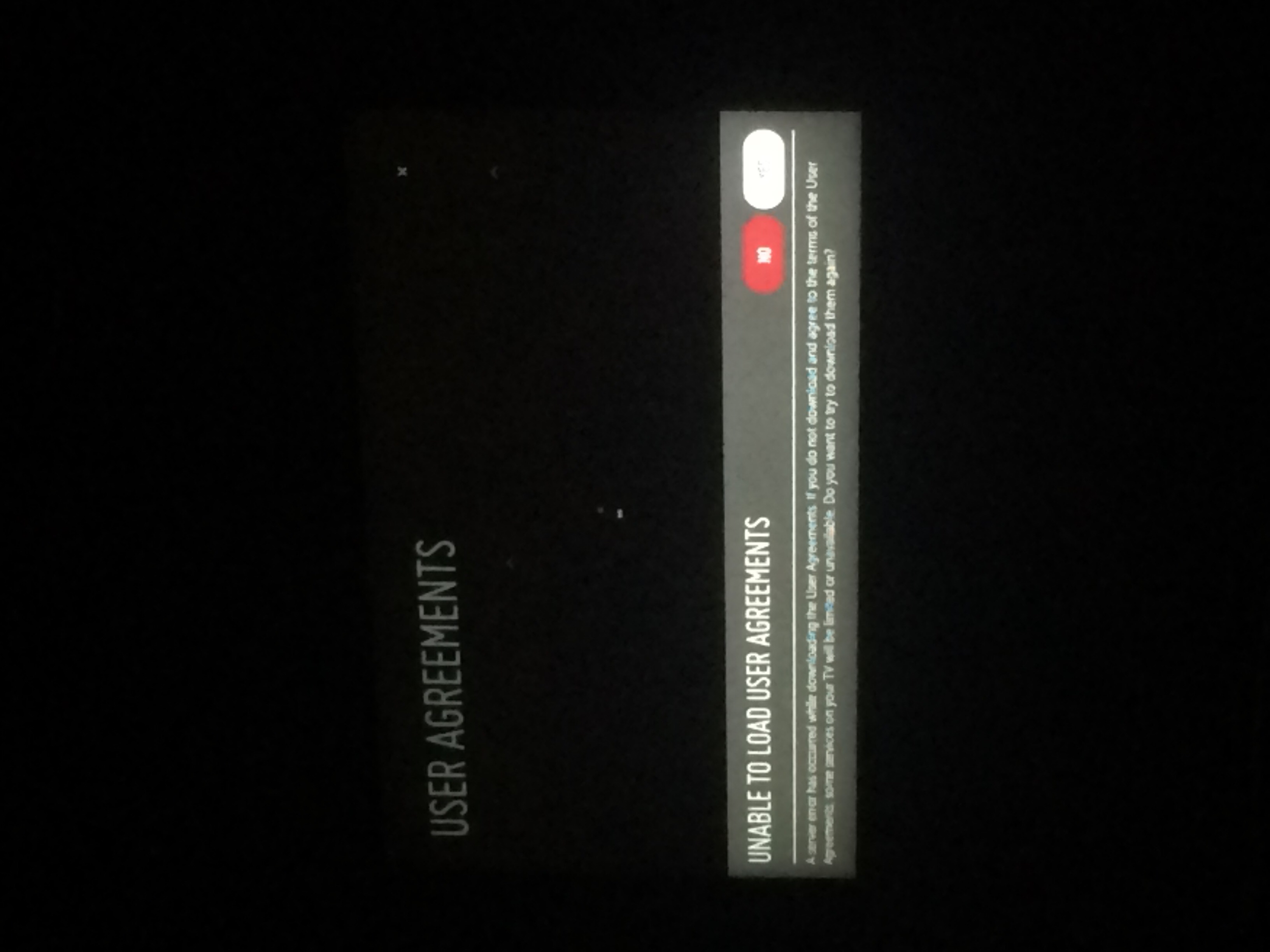

I regently got the LG 43UF6409 and have been pretty happy with it so far.
When I tried to open netflix or the LG conten store, it's starting to load the user agreements- those could not be loaded due to a server error(loose translation from german). If I retry to load those, it does not load either.
I've reset the TV to factory reset and it gives me the same error. It's connected to the wifi, shows me that it is connected to the internet but still won't load the user agreements.
Also tried to look for software updates (it's 3.20.40)- if I try to look for updates, it could not find any.

Just got the TV, encounter the same problem.  factory reset doesn't help.  I'm kinda stuck right now.  Attempted to update the firmware via USB port, but failed.  All the TV did was launching the media/photo player.
Hi, I had the same problem and after chaging the DNS in the Network settings, the User Agreement loaded.
Try changing your DNS to 8.8.8.8 (Google's free DNS).
Hope it will work !
