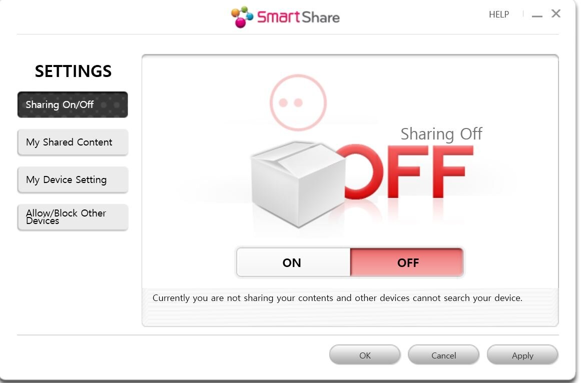

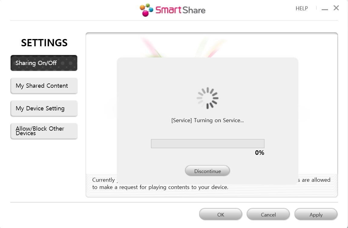

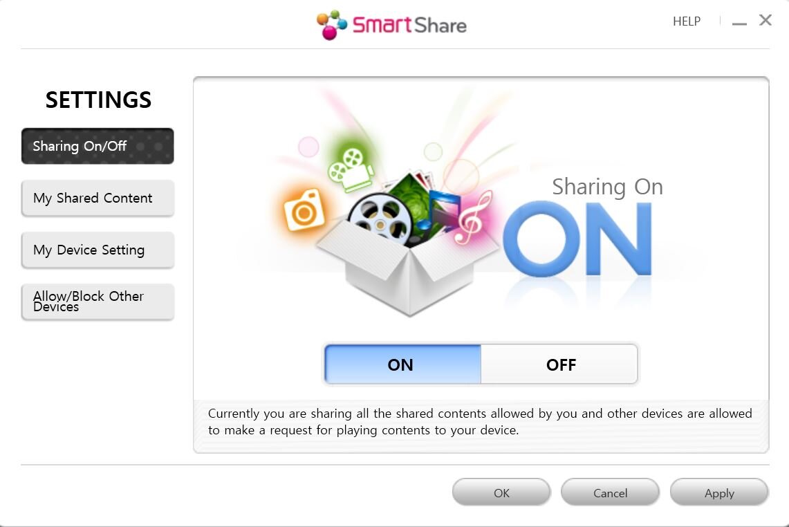

Up until about 3 weeks ago, everything ran just fine.  The SmartShare program was always defaulted to have Sharing ON, upon start of it, which is always when Windows boots).  However, about 3 weeks ago, the SmartShare PC program has started to randomly change its status to Sharing OFF.  I would then have to go into the program, manually change it to ON and then it works anywhere for 30 minutes up to 20 hours, and again, randomly change the Sharing to OFF.

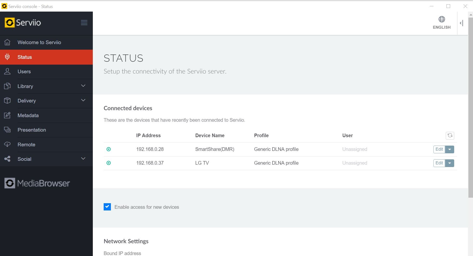

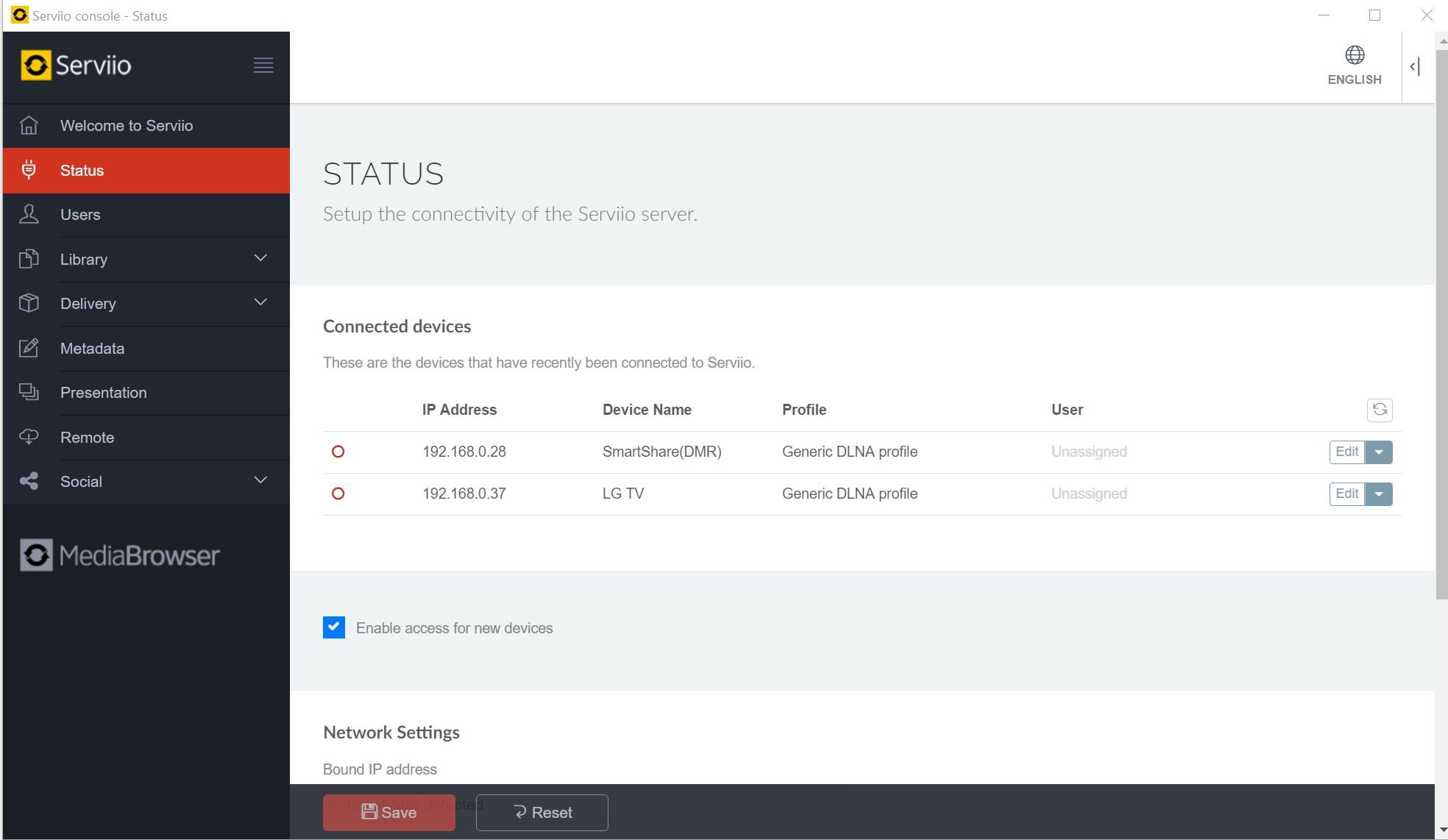

As an experiment, I installed an alternate Media Server program called Serviio.  One can also see that when my Sharing changes to OFF, the two green lights turn red.

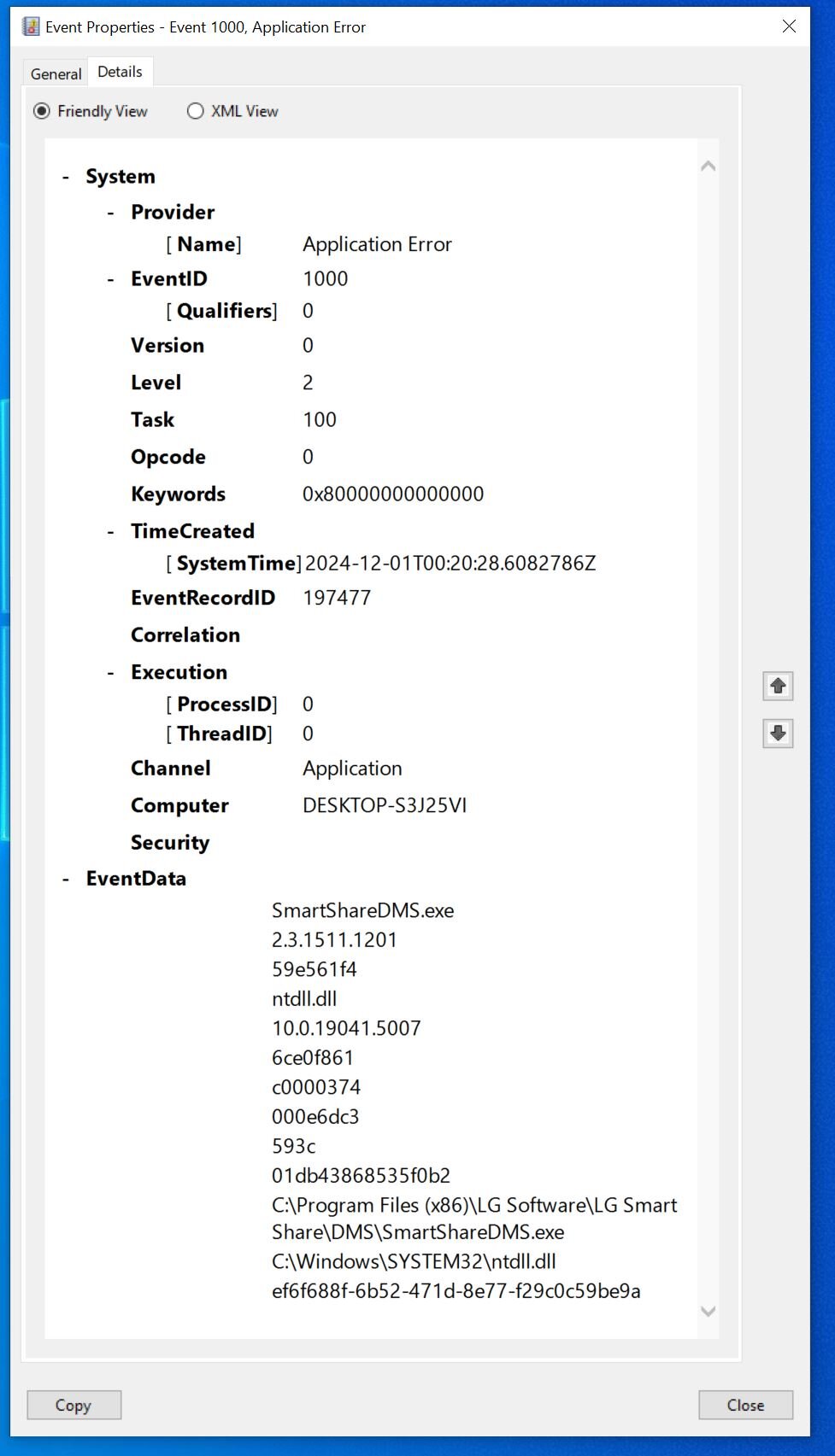

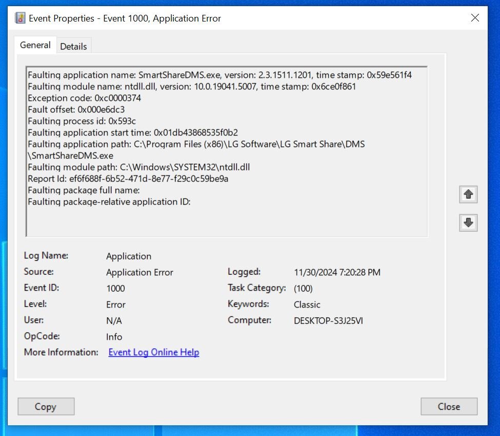

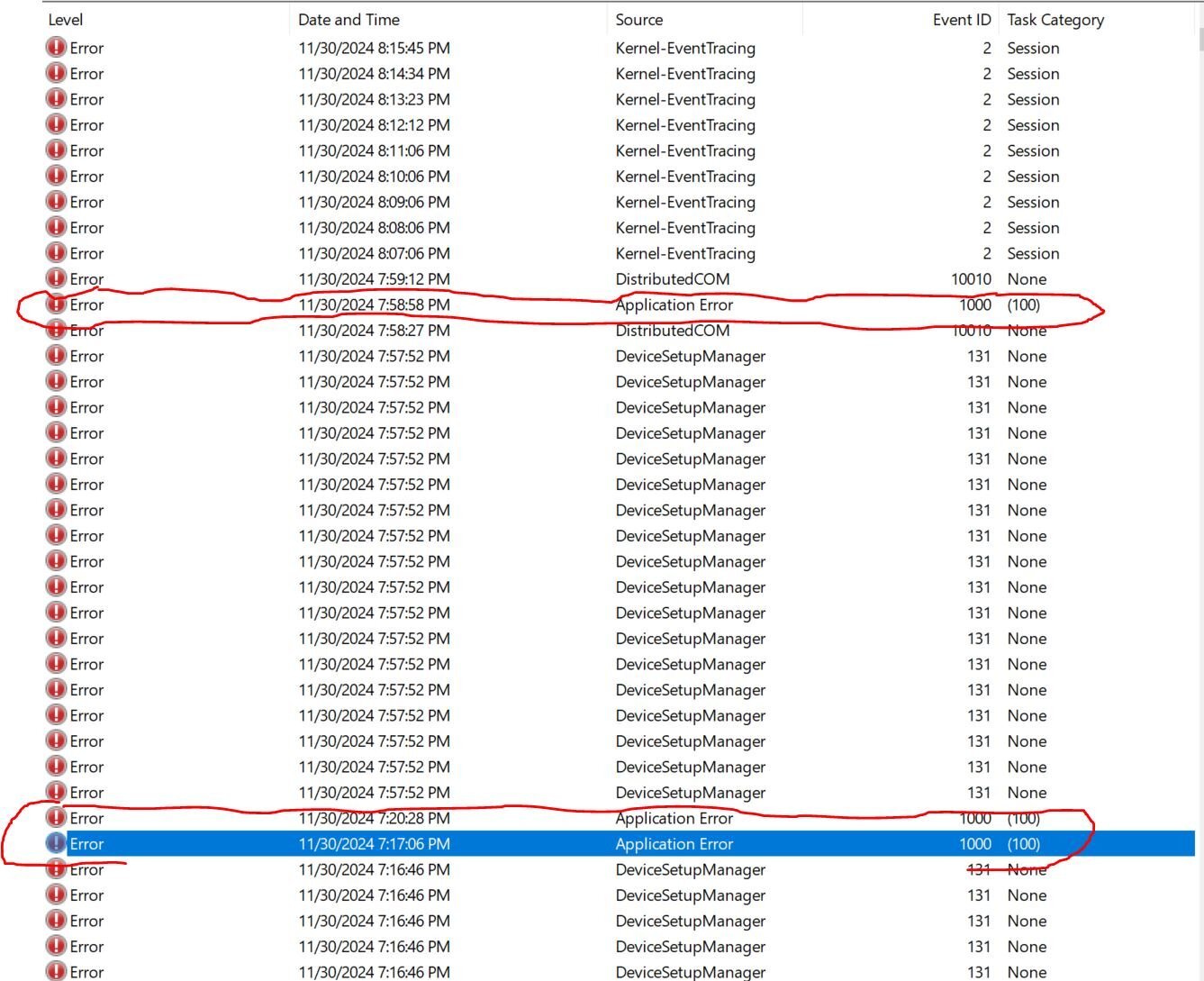

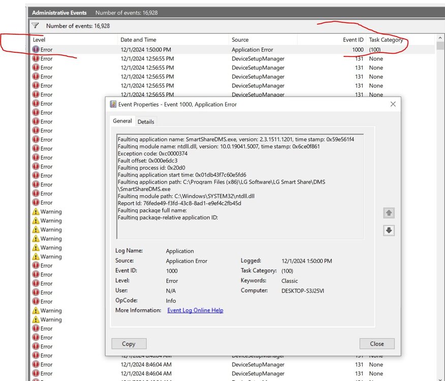

I searched the Windows Logs / Event Viewer and found all 3 of the incidents from last night. They are ALL the same, but I am attaching here a screenshot of one of them (with General and Details tabs) and also the log itself, with the 3 incidents showing. There is really nothing special happening before it happens (with one just back-to-back). All I would do is click Sharing ON (without exiting the program) to "fix" the issue..

Just in case, I also ran DISM ( dism /online /cleanup-image /restorehealth ) and SFC ( sfc /scannow ) scans to make sure I have nothing corrupt, and both came up clean.
After the reboot, it stayed up for 3 hours, and again, just turned OFF Sharing. I checked the Event Viewer log, and exactly the same error as I posted from before. It's here as the very last attachment.

In some way I feel better that it is not only happening to me, but still very frustrating.  Mine started a few weeks ago.   Maybe one of the Windows Updates broke it?  But why does it randomly work and randomly not work?    As you can see, I found the exact error code so perhaps someone with knowledge can help figuring this this out.
FYI: the error code 0XC0000374 is a HEAP CORRUPTION in the program you are running, in this case the LG SmartShare program. The error is picked up by the OS Kernel (the NT Kernel internals part that looks after bad memory allocations, de-allocations, and buffer overflows, and invalid pointers).
Basically it is a bug in the LG SmartShare program, and when it crashes, it most likely reverts to default settings, that turns the sharing off.
You will need to report it direct to LG, this site is ONLY a user to user forum

As promised:  After uninstalling LG SmartShare and installing Serviio (free version), and running it for 5+ days now - no problems.
Looks like I found my new Windows / LG  MediaServer.   And the fact that it runs as a service automatically, actually makes it easier.
