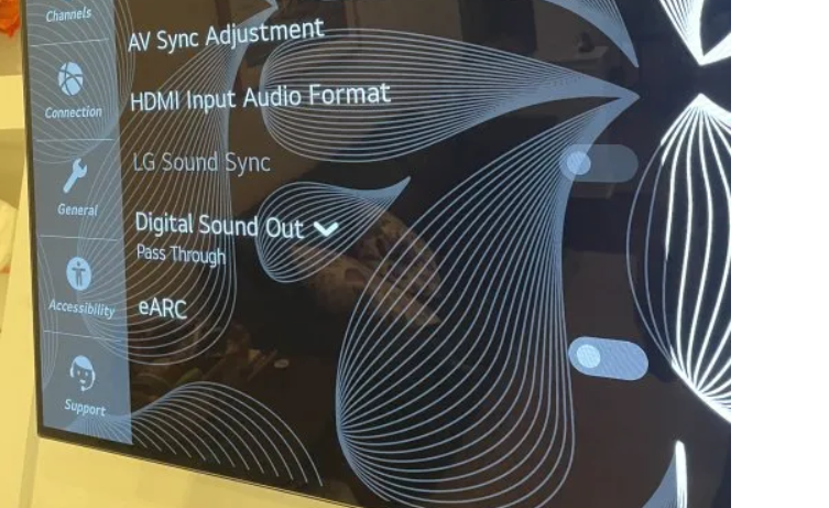

  5. The eArc option seems to be off and if u turn it on, it might work. Else take a look at this post:
  6. Thanks it works for me. The steps I wish to emphaise is make sure you remove all connectors from the ports. Power off the TV and sound bar, starts off with the ARC connection first. My soundbar is from Sonos but I faced the same problem describe here.
