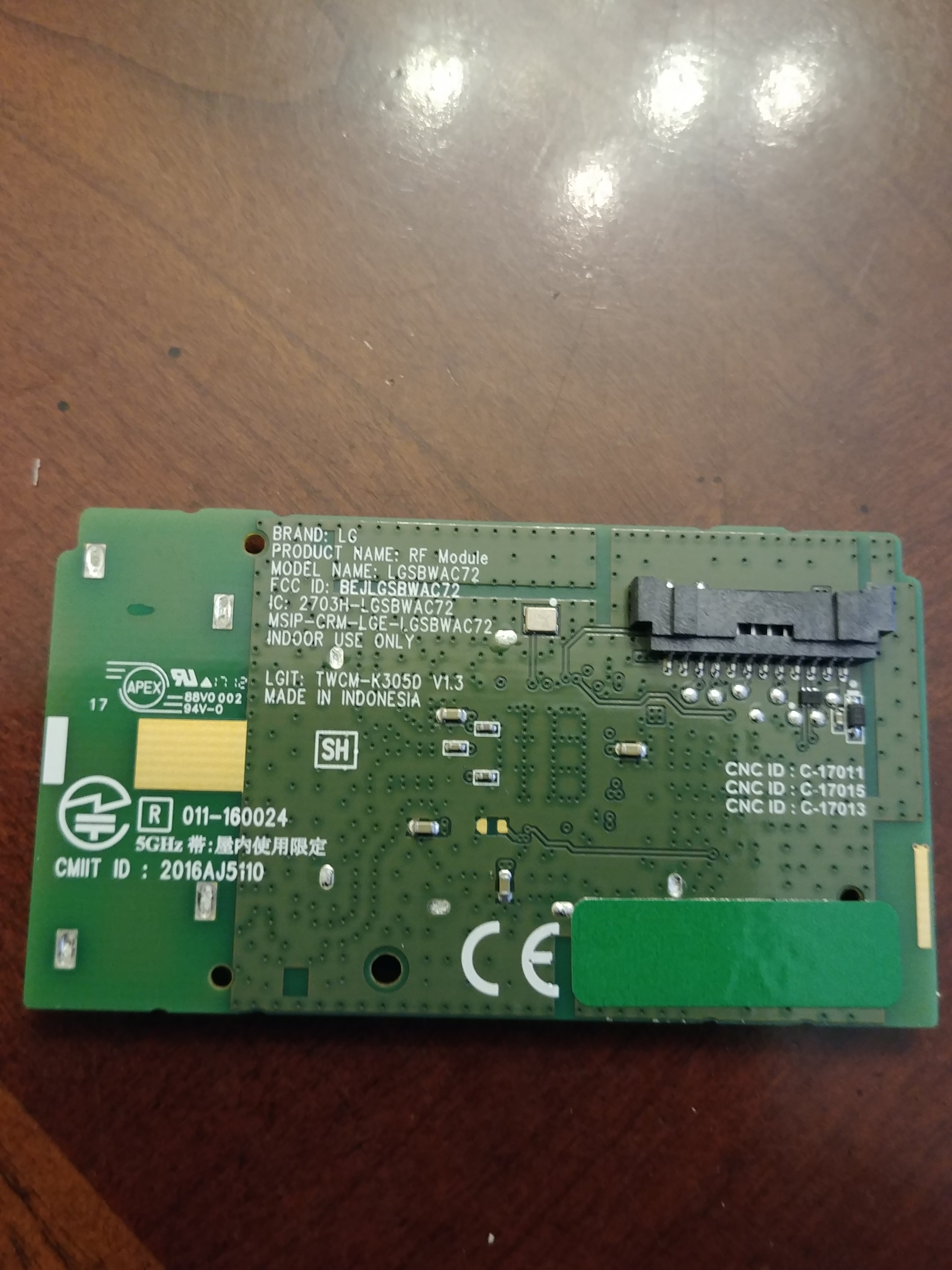

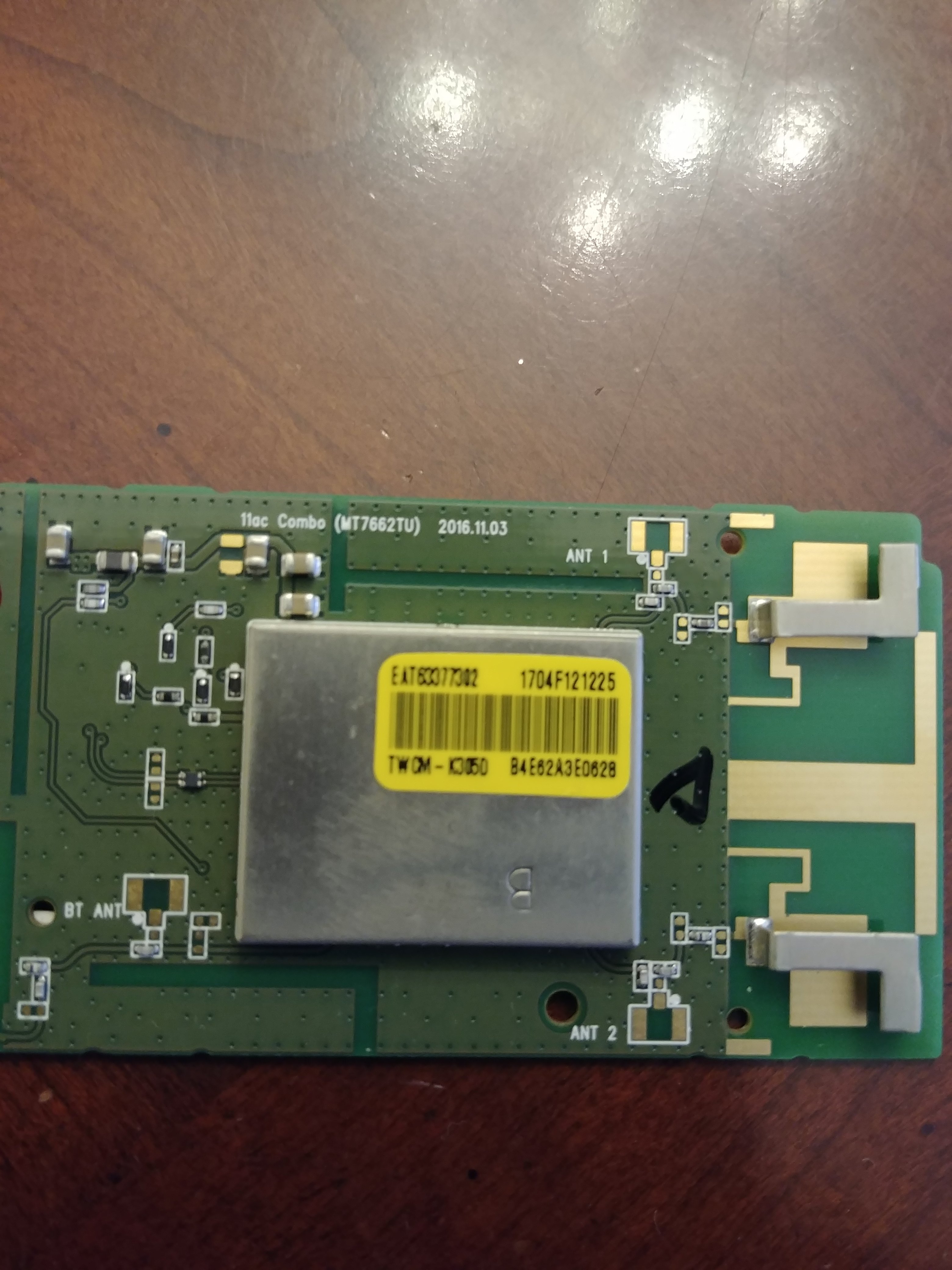

  1. Please find attached the pictures of the faulty rf module. Since is a common fault on many tvs, please make arrangemnts for a replacement. I may send you my address if requested. Thanks Thomas xydas

  9. Solution to this Fault on LG SJ810v I had the same problem with my 49sj810v (random messages connected- disconnected devices, the wifi could not detect any networks, and the magic mouse could not connect(could not register as the bluetooth had to be initialised)). SOLUTION: Have replaced the RF Module (EAT63377302 WI FI MODULES & 3D TRANSMITTERS FOR LG GENUINE 49SJ810V). Now everything is working Fine. Hope this message will help other LG tv owners that LG will not help.
