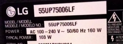

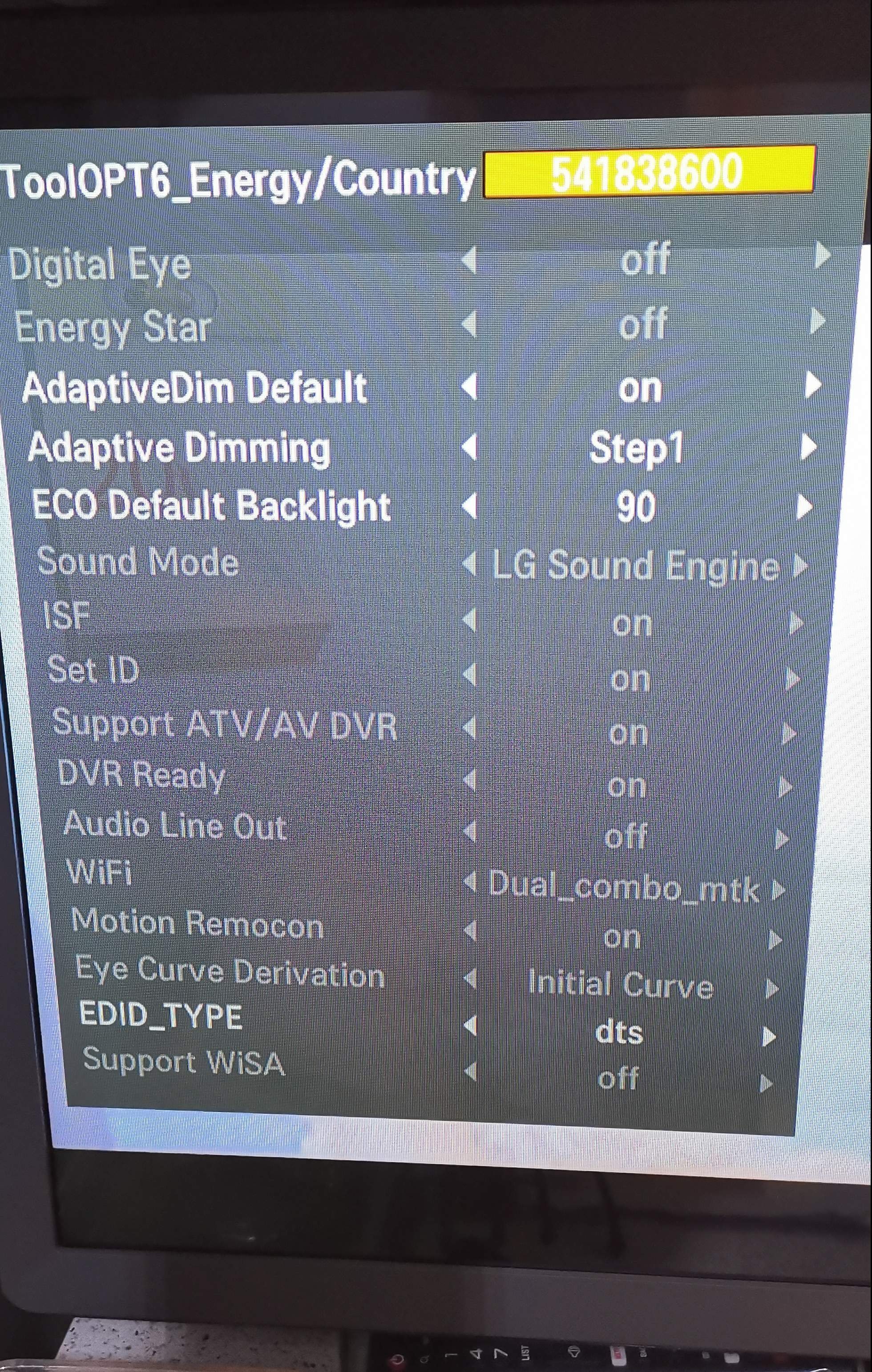

  2. Also a friend of mine would like to activate dvr... His model is 55UP75006LF also you have this tv? I haven't had time to check the original code on the service menu yet.. Can you confirm me if the dvr unlock code is the same - - >541838600 ?
  3. Thank you, 541838600 it's OK , DVR and Timeshift enabled !👍 I haven't changed country and everything works fine 😀

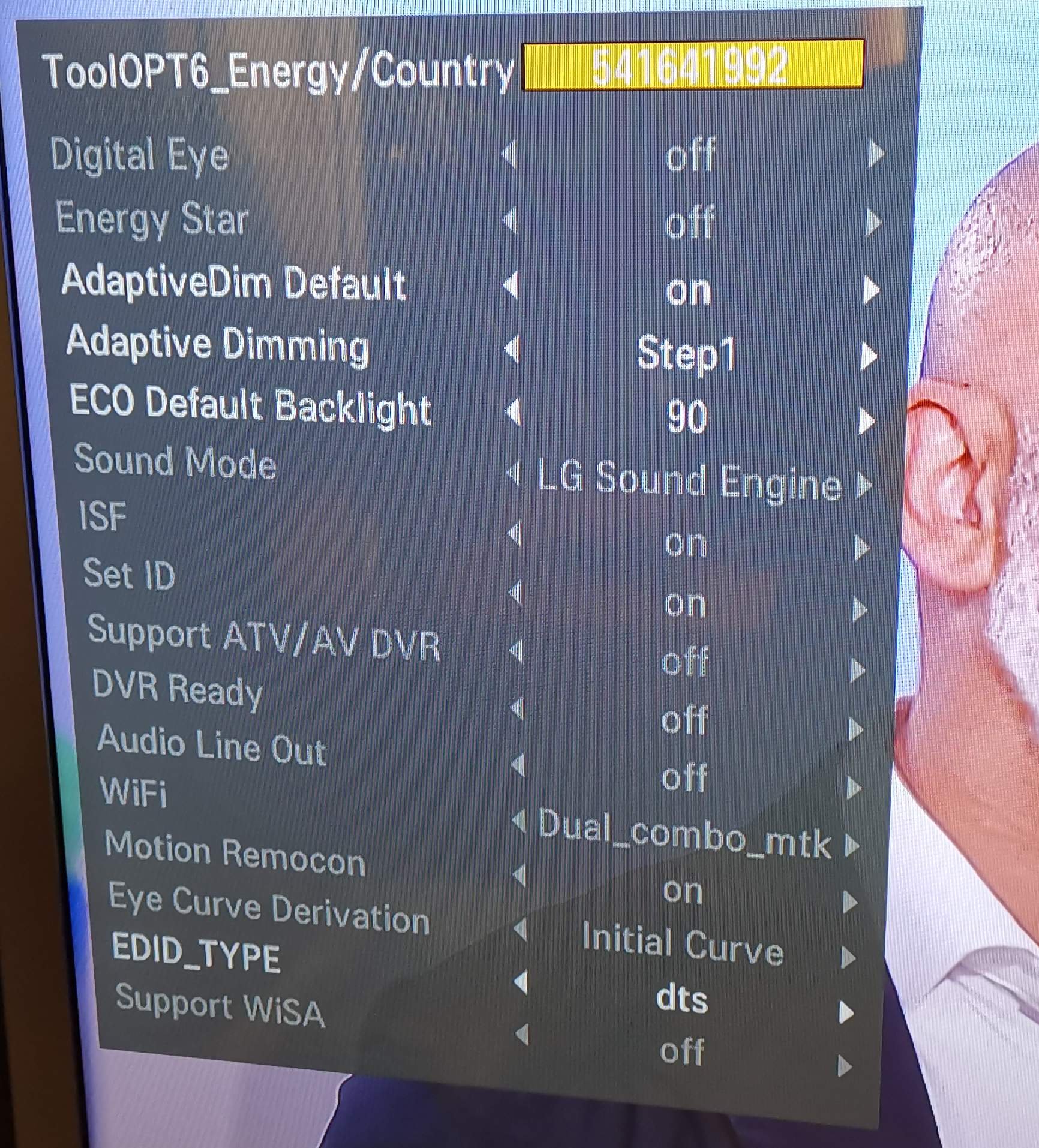

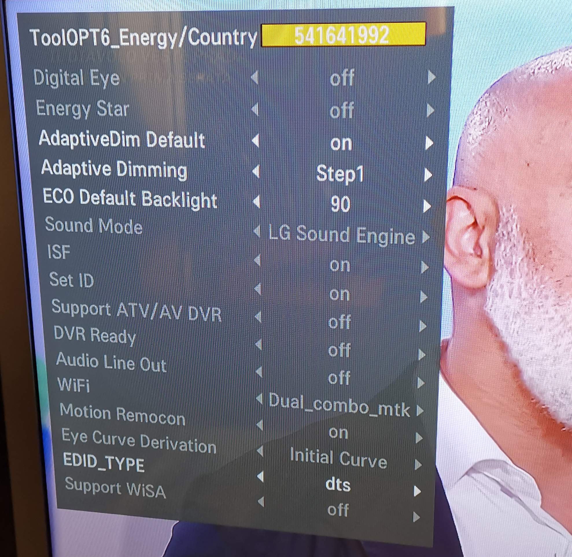

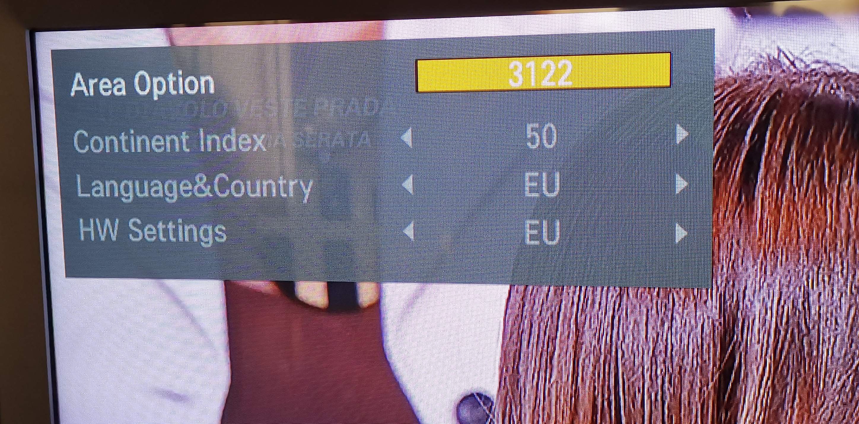

  4. Hi, could you help me please? Whats the code to enable DVR in my ToolOPT6 menu? My code now is 541641992 my country is Italy area option code: 3122 Thanks
