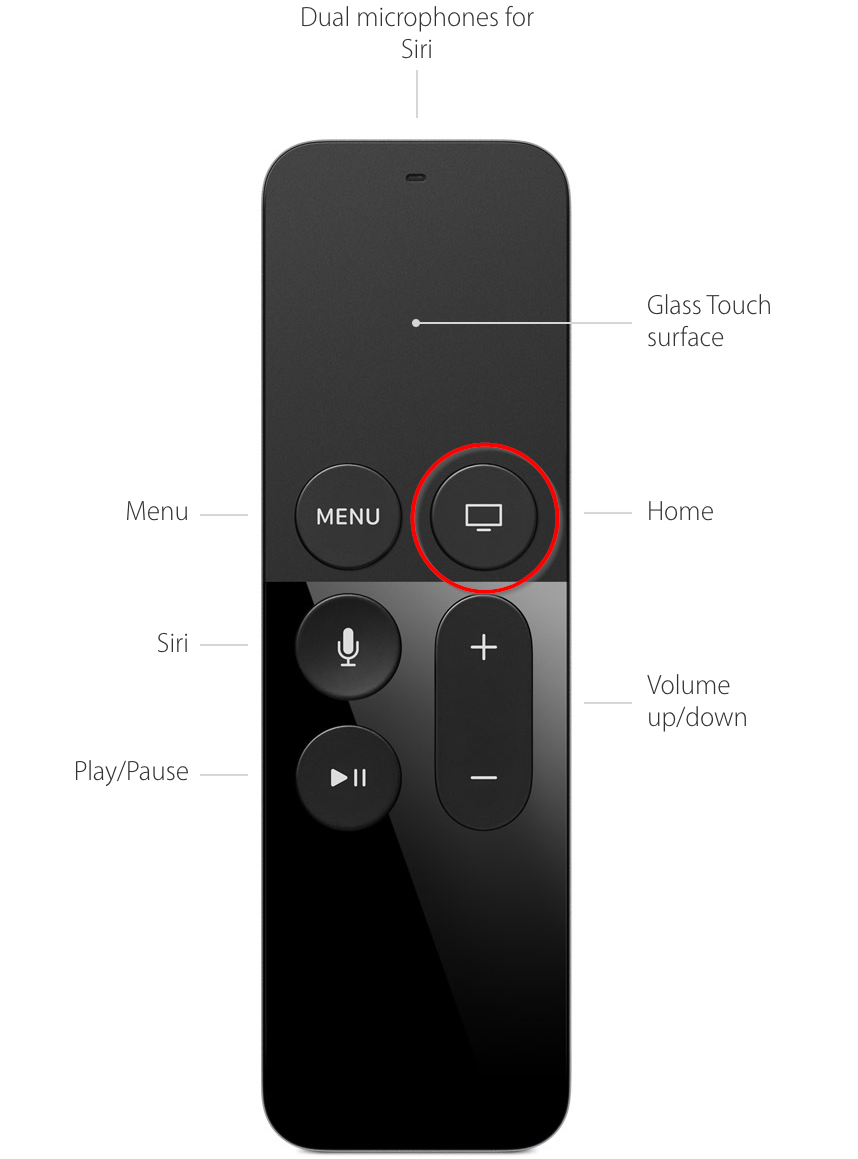

  1. Thanks for the tip, I will have a look in my TVs as well. Another thing I've noticed on one of my models is if I wake up the Apple TV with the Home button on the Apple TV Remote it seems like it also more reliable switches on the LG TV. I suspect this causes the TV to wake up, not from HDMI-CEC but rather that the Apple TV Remote actually sends a wake up IR signal that the TV reacts to.
