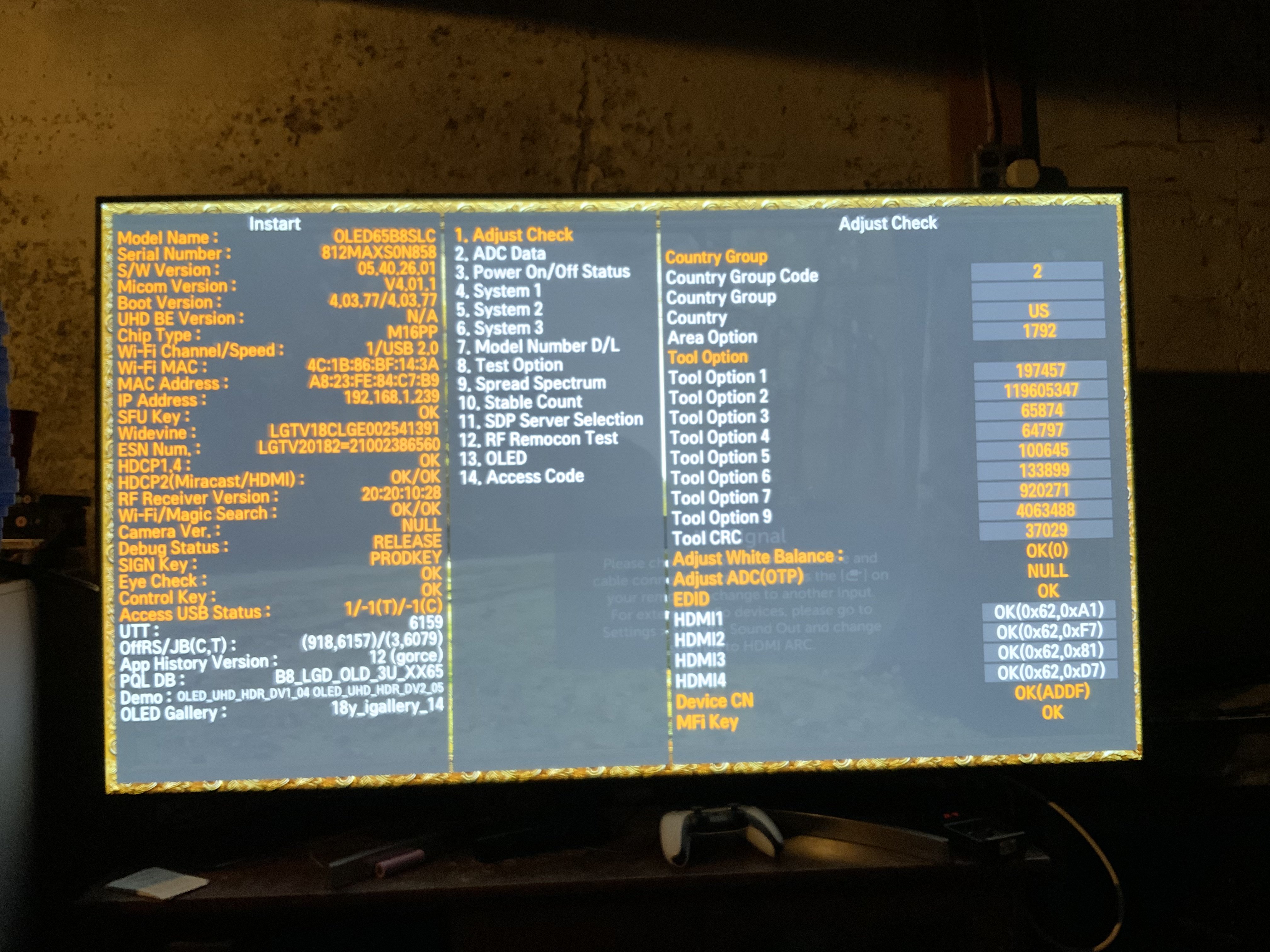

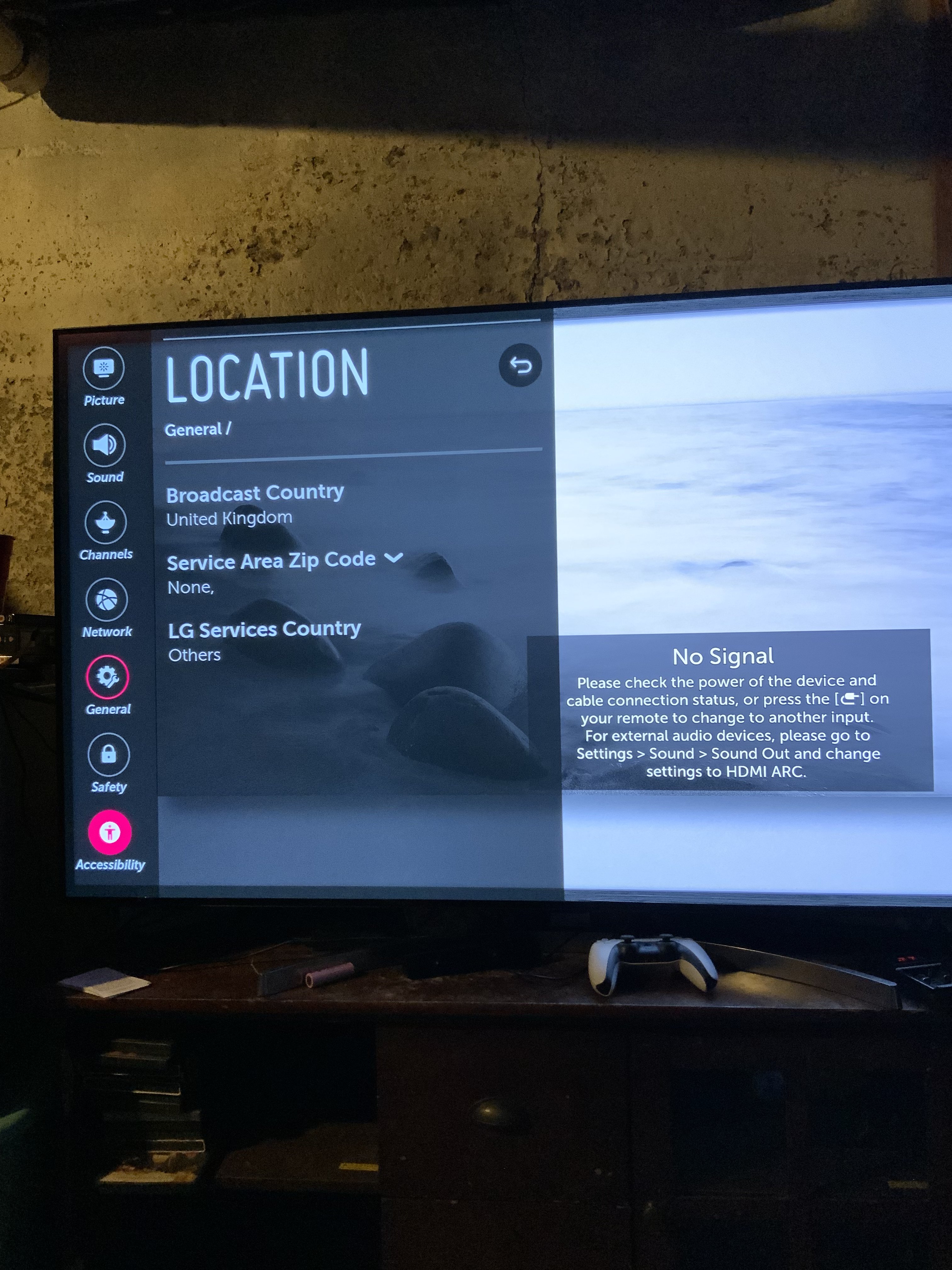

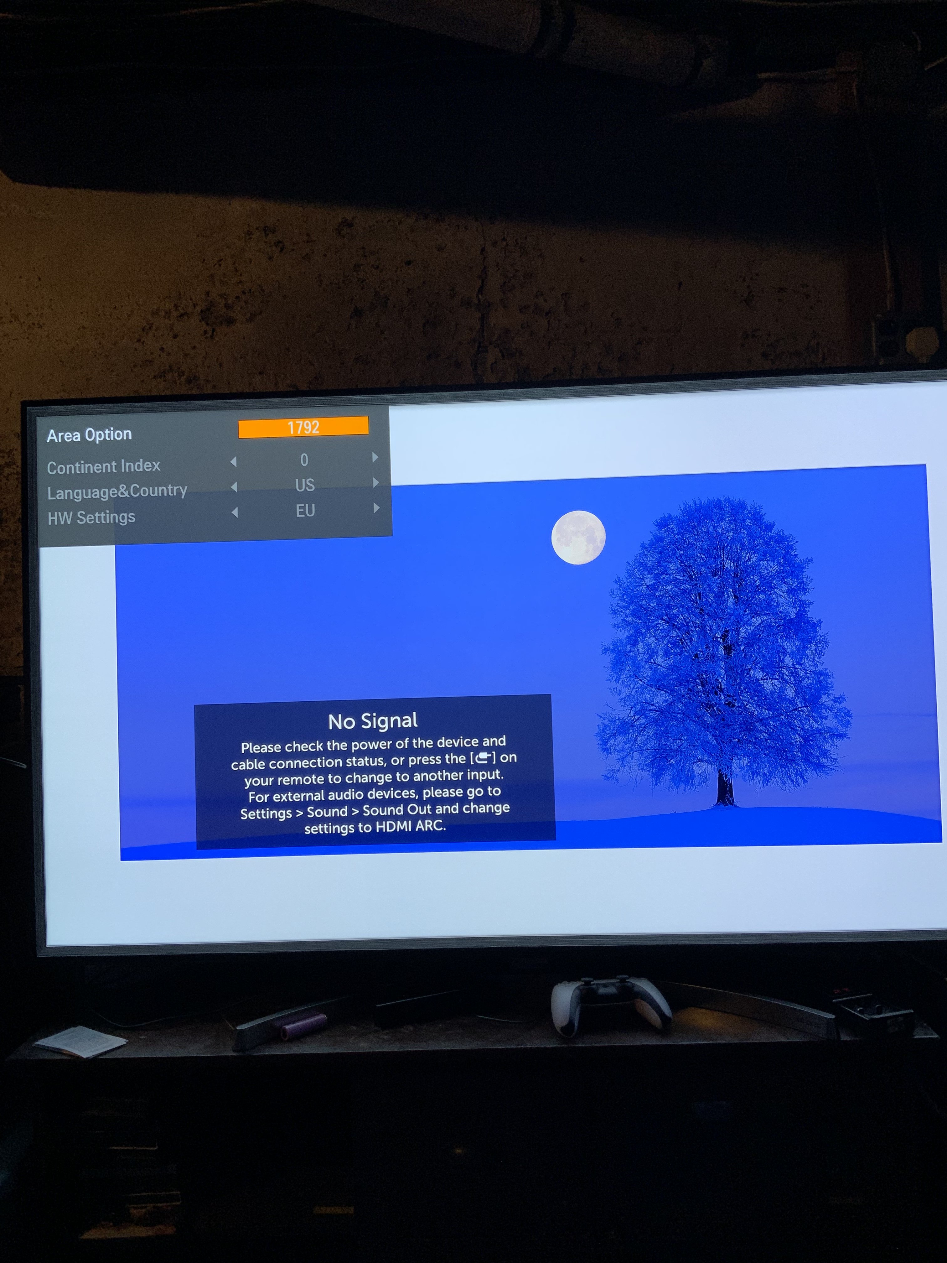

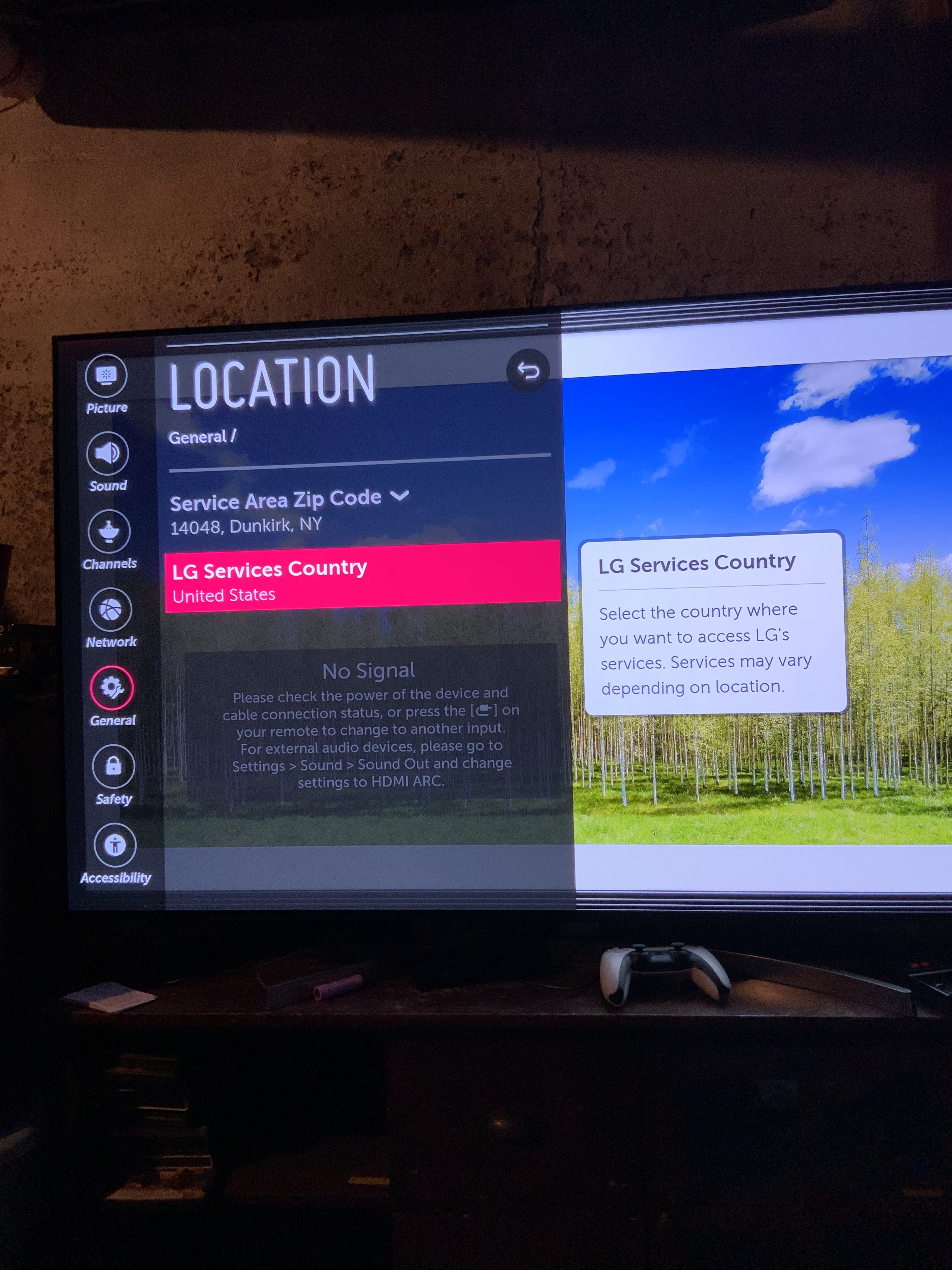

  1. Hi. I have an LG OLED TV that I originally bought while living in the UK. Specifically, it’s model OLED65B8SLC. When I relocated back to the US, I shipped the TV home as well. I’ve since picked up a service remote and changed my original country code of 3123 (UK) to 1792 (US). Oddly, while everything else seemed to update just fine, it still shows HW settings are EU, despite the location in the menu as now showing as the US. Also, the continent index is 0, when I know it should be 10. This leads to no broadcast country being shown in the location menu. I’ve tried every US country code from 1792 to 1919, and none of them seem to change this. Are there any other possible US country codes anyone might know of worth trying? I’ve attached photos of my current location menu, along with how it looked before. Thanks.
