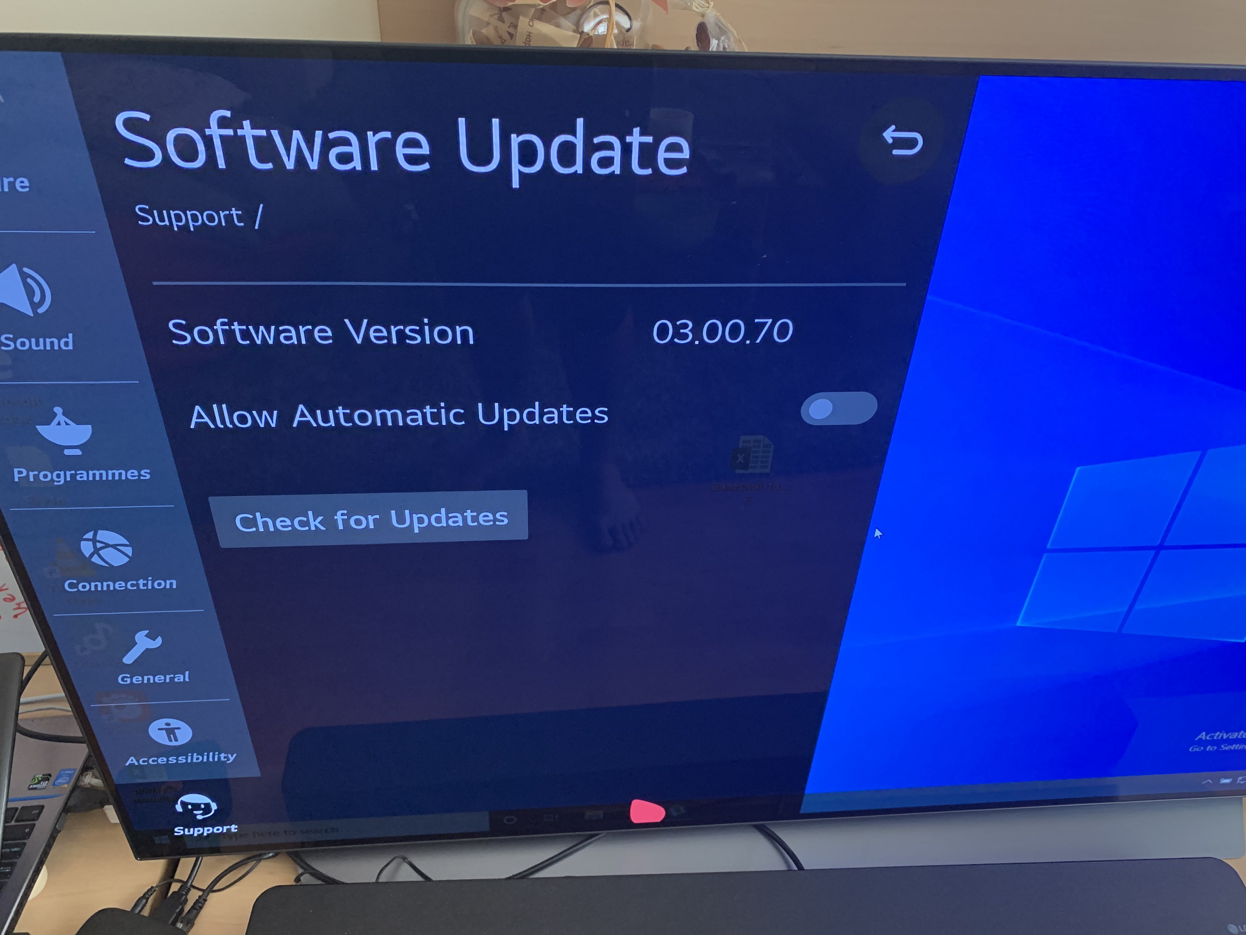

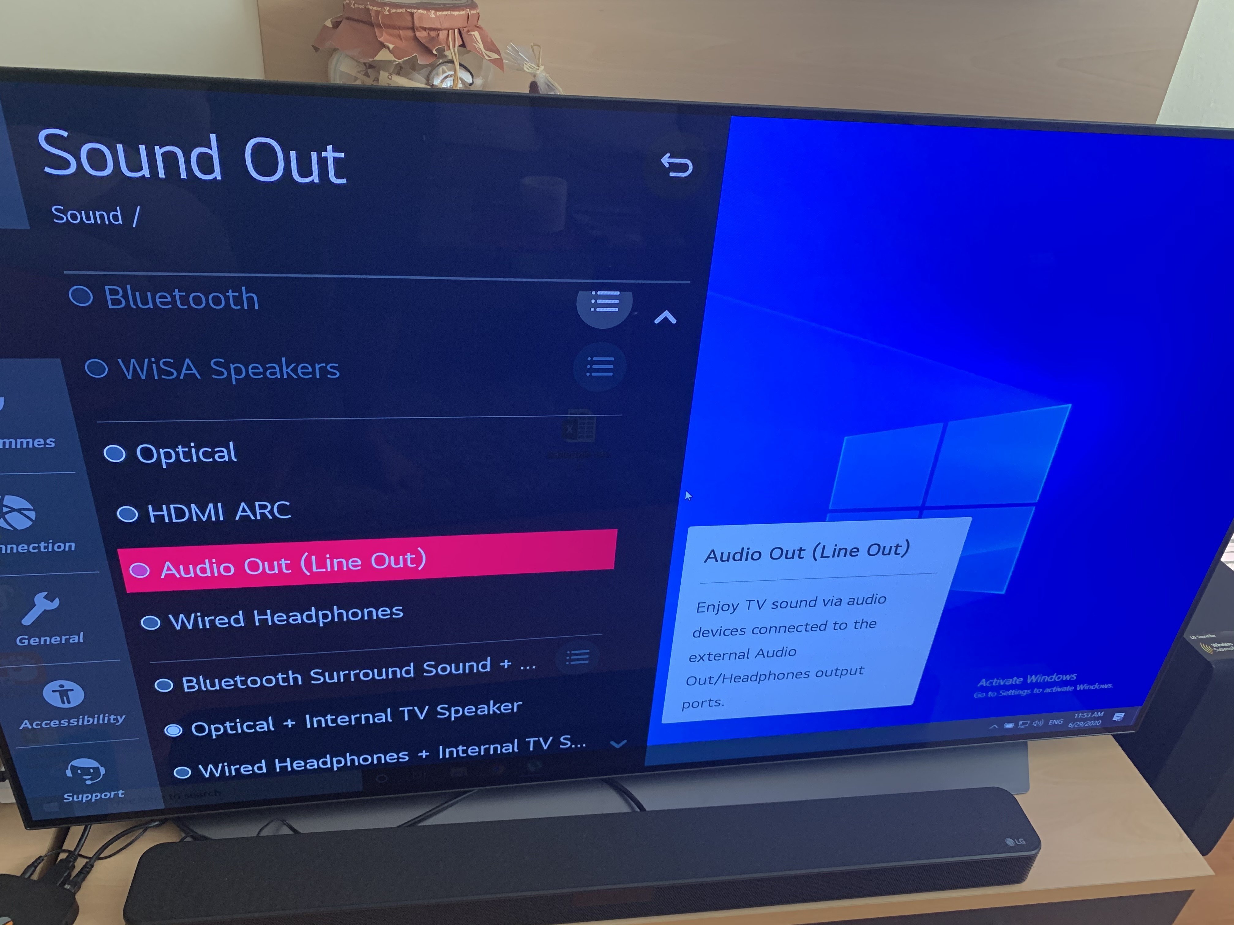

  2. Hello Krishna Kumar, Thank you for the help!Unfortunately my TV does not seem to have TV Sound sync as option(Uploaded picture of the current options). I previously had the soundbar connected via bluetooth but this had a lot of issues from sound delay perspective(issue with TV crashing was still visible), so i had to connect it via optical cable. Also i would like to still use internal speakers + soundbar as audio. I also did the pixel refresher procedure 2 (or 3 times, not sure) already. Also uploaded picture of the current software version - no newer one when i press check for updates.

  4. Small update - i also tested by changing the sound set up to only internal TV speakers - issue happened again.
