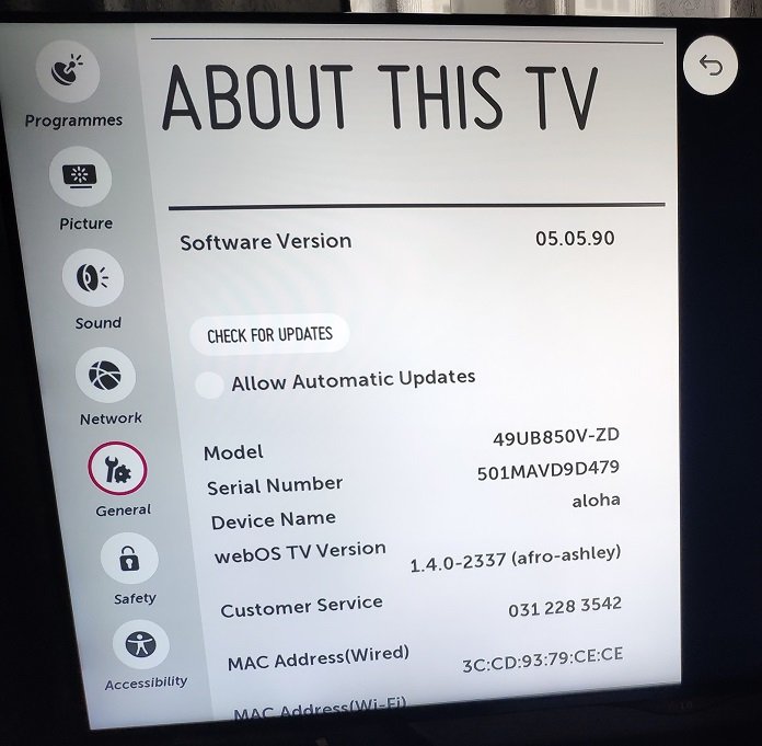

  1. I still recommend you open up your TV and make a picture of your main board. Look it up on the internet and you can buy it for 400-500 lei. Just plug and play. It worked for me, it will work for you as well. The issue comes from the HDMI connector. Sometimes it shortcircuits the board in a way that some functions stop working.

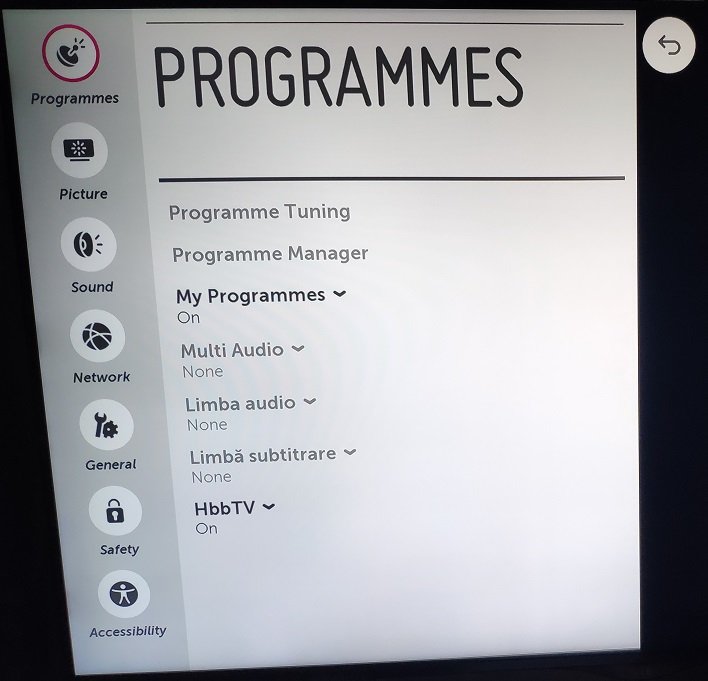

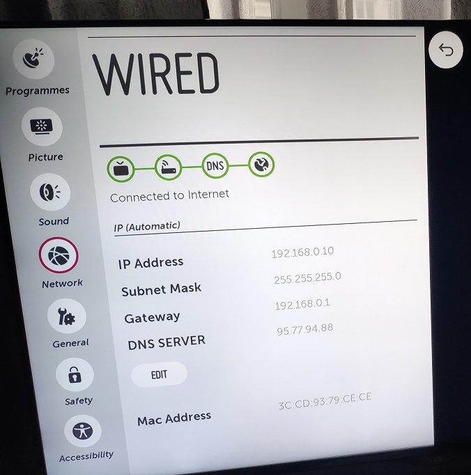

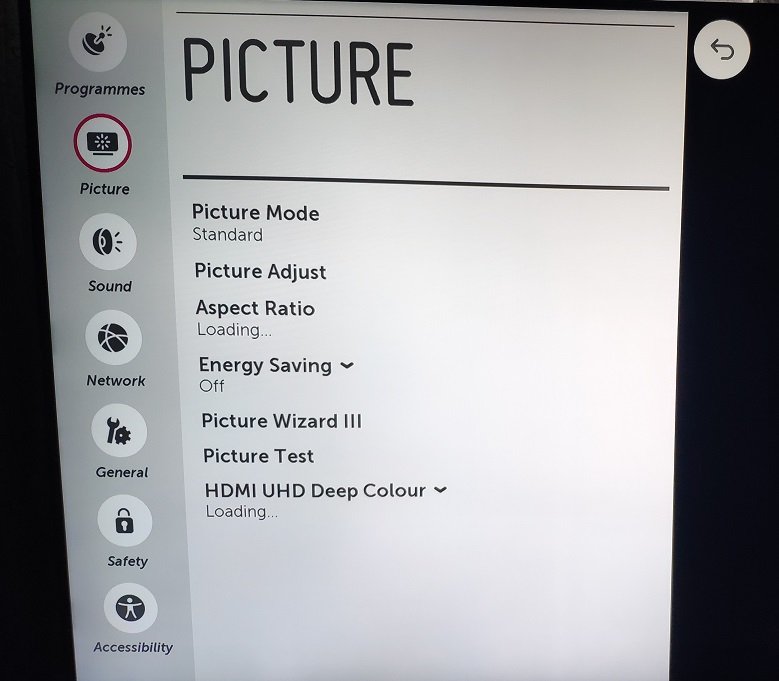

  2. Good afternoon, I have a 49UB850V-ZD smart TV and has the issues below. Can't understand if its a software issue or components issues: 1. Can't reset using meniu. I can access the meniu, I inserted pin 0000 and if I try to click Confirm it just flashes the button with no success. If I click Cancel then the meniu closes 2. The Live TV channels are not working. There is no issue with the provider. It just not plays any channel 3. If I connect the usb or hard-disk driver to play some movies I can navigate thru folder but I can t play any 4. When I connect to Netflix or youtube I can navigate but if i try to play it does not load. 5. The remote TV does not work anymore -> Only the Power Off/On button 6. I have a magic remote TV for LG and works to navigate with the indicator 7. The button of the TV (under the TV led) works only to open the TV -> the menu does not work anymore 8. In the advanced menu, the Channel settings is not active among other options that are disabled. 9. When I try to access the LG STORE it says: loading unsuccessful (82) because the hour of the TV is not the correct one. I tryed to change time to something different and also changed location and removed the location. This change did not had any effect What do you think? What do I need to do?
